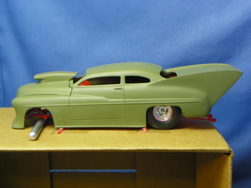

Here are the pictures of the start and the car in primer for the first time.
I am not sure who made the body but here it is.
I used a piece of .065" styrene to fill the hole at the top of the spoiler.
Broken Cowl
I added .020 worth of styrene to the back of the hood to fill in the gap.
This is what it looks like now.
So this where we are at with it now. Some more body work to do and need to find a chassis. I think maybe one of the new Ross Gibson engines.

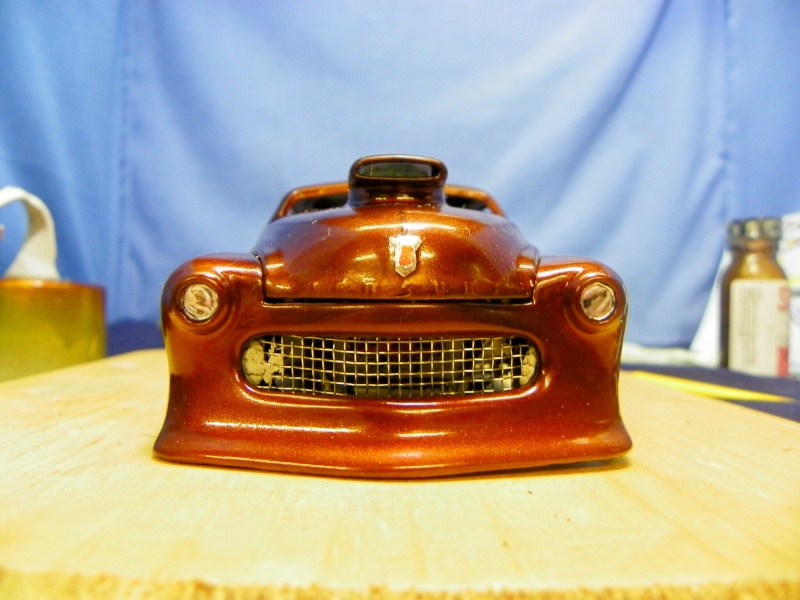

Same up front. kinda a funny opening for a grille. I had thought maybe some wire mesh of some type. Then again maybe the AMT kit can ante up a grille that will work.

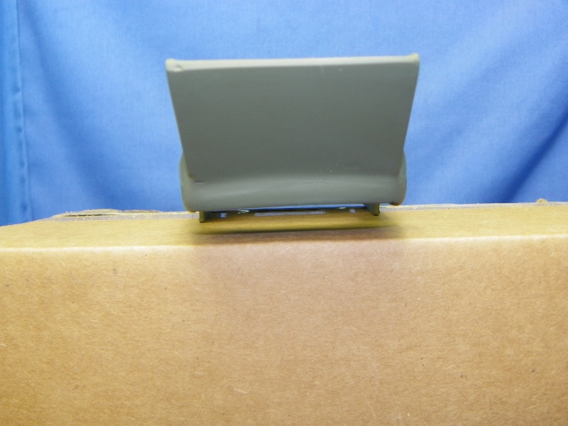

Thanks for the input guys. Seems everyone thought to scoop was the answer and I agree. Sooooooooooooooo. Here it is.
made a template of the scoop base. Then marked the cut line.
Some sanding, CA glue and putty we have this.
Here is a look at the finished scoop in place.

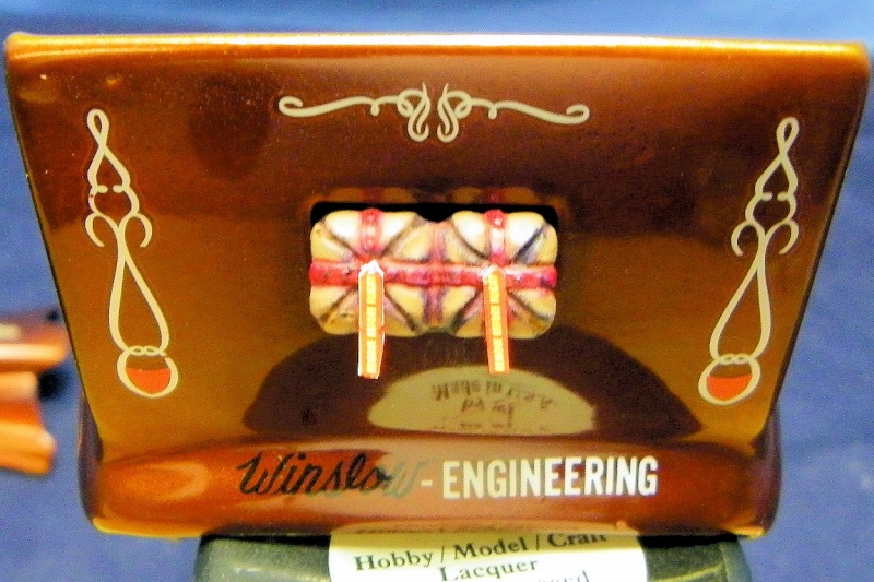

I wanted to breakup the big flat back end. I found center then scratched a box and mounted twin drag chutes in it.
NHRA says that a bracket car must have at least one tail light for night drags. I will do something with a light just not sure what. 2 ideas I had were 57 Chevy with the chrome spear going up. The other was a single light ,like a center brake light on a newer car, toward the top of the wing. Just some thing to break it up a little more. Any ideas?

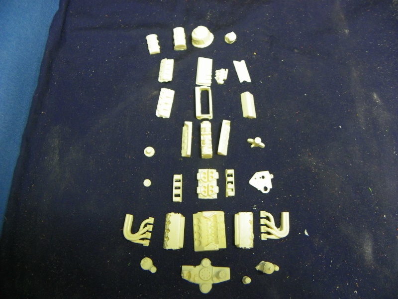

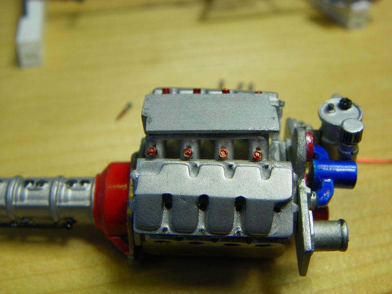

After 2 days of sanding and filing and drilling and well you understand I have this.
The basic engine block is 5 pieces. They are far from flat or square when you start.

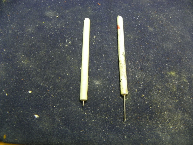

The best tool I have found for working with them is a mirror with a piece of 400 grit wet and dry sand paper taped to it.
This gives you a flat surface to sand the pieces on. Also a home made center punch. I use a piece of spruce, drill a .025 hole in it. Then I can cut the head off a straight pen stick it in. Also handy for applying small dabs of paint or glue.
The reason you need them is. The engine has a dry sump oil system. Ross Gibson has cast a small dimple into the parts that need to be drilled for wires and hoses but the dimples are not always in the center. This resin is very brittle and if you aren't careful you will break it. Then you got a 20 dollar engine kit to throw in the scrap yard.
Anyway the block looks like the engine will fit. Might be able to use the kit headers and might end up building them either way it's a go.

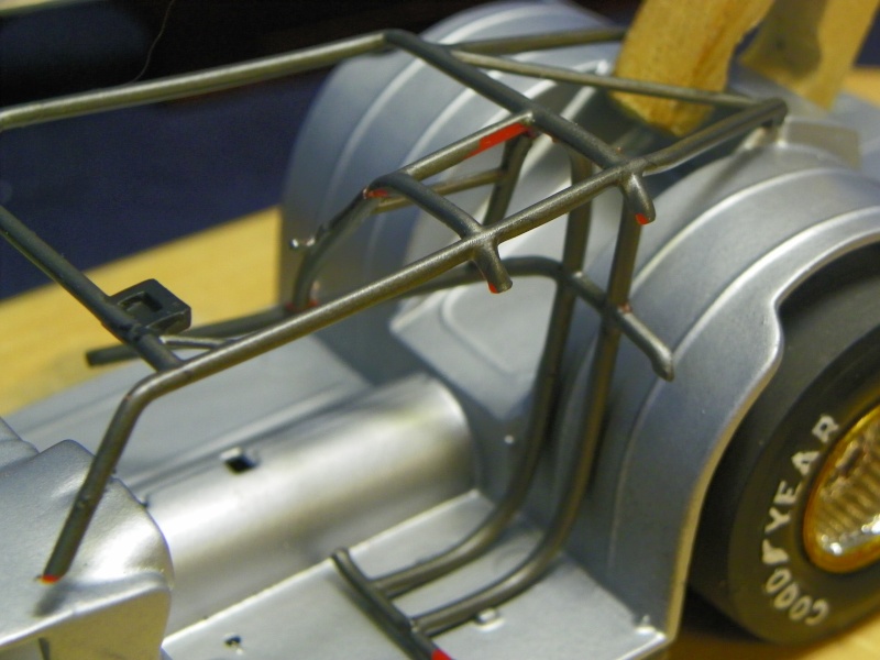

I got the roll cage all cleaned up and painted. Have the dash location figured out. Then started on the NOS bottles and batteries. Thought I could start the detail on them while the glue is setting on the frame.
So what's next? The first thing to build some engine mounts for the side of the block to rest on. Then the front bars will have to be changed to fit around the engine. I am going to try to scratch some front shocks and using real springs again. I have a few shift kit springs left. I need to finish the engine also before the bars are made. So most of the work will be on the front end.

I started out by putting as much of the motor together as I could. All that is left is the detail. This gives me an idea of how big it will be.
I went looking for headers. The headers from the Christine kit were perfect. The exhaust ports all lined up and they fit. Man that was easy.

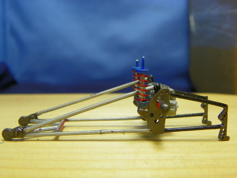

I had to cut the center bar out of the front end. This will be replaced later when I see what kind of room I have. Then I hung the kit front struts on it. They just look hokey.
So using some aluminum tubing in different sizes, a shift kit spring, some blue anodized craft wire and some Dulpi-color red and blue anodized paint I made a set of these.
That got the front end looking like this.
I hate to say it but I may have to make another set of these. The front end may sit to low. If I do they will be just like this but the spindle will be lower.
Here is were we are at.

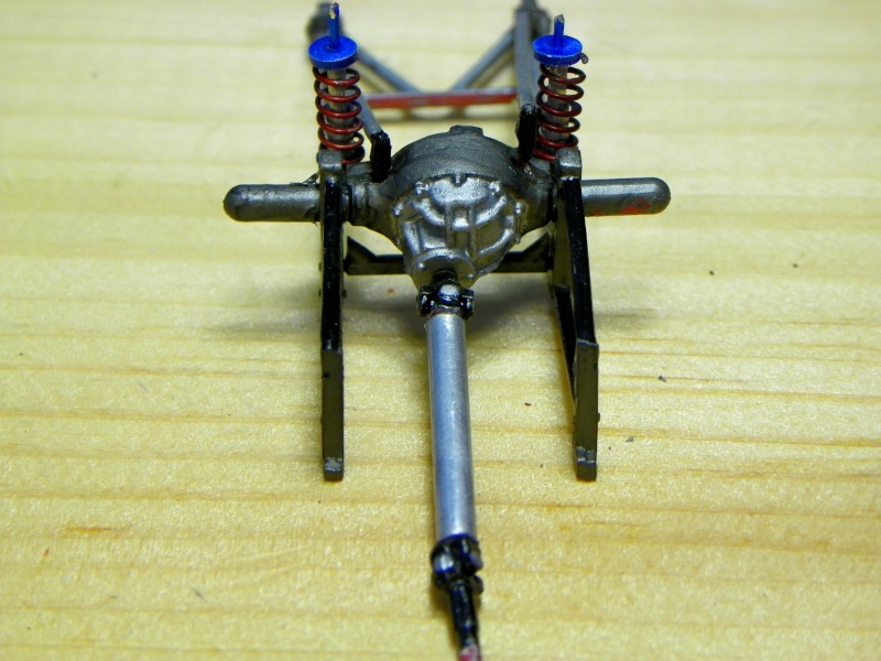

I did get the back half done. Then I worked on the rear tires a little.
I cut the kit shocks off the 4 -link and drilled the 4-link mounts with a .025 drill bit. It was easy and looks a ton better.
When it was put together it looks like this.
The drive line is 3/32 aluminum tubing and the kit u-joints.
With a set of slicks on , it looks like this.

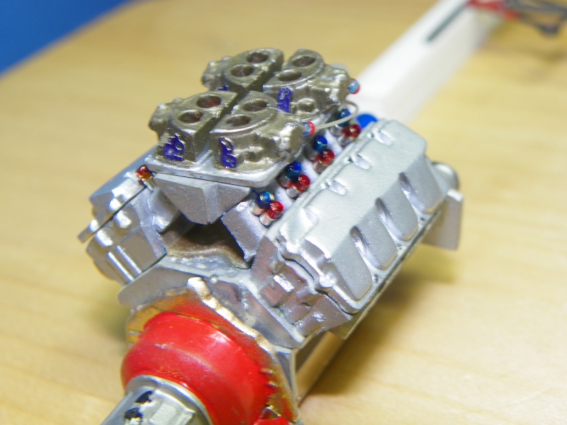

Here is the intake with the plumbing for the carbs.
Then using craft beads and craft wire I made up two sets on injectors. The red ones will be for gas and the blue for NOS.
I know that both sets have red anodized wire for a center but that's the only color I had in 22 guage and that's what I needed for the hole in the wire crimp. When they are installed on the intake the wire will not show anyway.
Also needed some type of fuel distribution block. This is my 4TH and final design.
Here it is added to the intake with the carbs plumbed into it. The injection lines haven't been added yet.
Then I added the throttle linkage. This should make the intake complete.
The gas injectors added.
Then NOS injectors added.

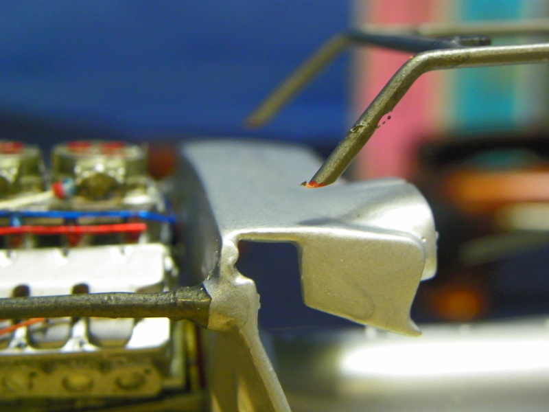

I scratched a small coil and added it. Also the cover on the distributor is scratched. I tried to write MSD on them but could not get it right. Couldn't find a decal small enough so plain red it is.
After it was installed into the frame for a test fit the red flag ran up. The dry sump hoses are going to be to long. I tried to get them loose from the resin pan to shorten them but no way. I didn't want to break any of the resin and then have to do repair. I decided to use some .007 " craft wire to tie them up to the frame rail when the time comes. This will give you an idea of what I am talking about.
I will call it good on the engine now. Man that Ross Gibson engine was a kit in it's self. I should write a review. So now on to the body. I want to set the glass into the car. I want it to look like a street car. Who ever made the body left no lip to work with. What I have decided to do is use .020" craft wire to build a frame into the window openings. In scale that is .500 or half an inch all the way around. Here is where that program is at.
So until next time that's where I am at. I hope to have a bigger update by next week. We'll see how this window frame thing goes.

The fittings
Front half
back half.
scratched caliper and lines on rear end.
Back half is put on with 5 minute epoxy. The whole frame is put together with epoxy.

So now I could put the body on it and set the ride height. I cut the firewall to let the front end come down more.
This picture will show you how I plan to do it. There will be a small box build that goes back into the interior. That box will rest on the dashboard.
This picture shows how much more I need to come down. It also shows the amount of engine set back.
And last but not least with the hood on. I think I will bring the front end down about 3/32" at least a 1/16.

I let that sit overnight and then put on the Candy Root Beer Brown. I know I didn't need to wait overnight but was being very careful at this point.Here she is in Candy.There is no clear on it yet just base and candy.
That left me with 2 questions. What would it look like on the chassis with the gold bead lock rims? Second how would the Aluminum and Metalizers look with the brown? Here is the answer to both questions.
Question 1
Question 2
About 3 years ago I bought 6 model boxes full of parts for 15 bucks. When I got home I found this treasure in one of them.
In the short few years I knew Bob Paeth I bet he told me the story of this decal 10 times. He even had one of the original kits that it came in still sealed. He had this decal sheet printed and put into the kits without Revell's approval. It almost cost him his job. The names of 4 Revell employees are on the sheet. Keeler,Paeth, Jones and Winslow. I know who Keeler and Paeth are but the other 2 not sure. I know they worked with Bob and Jim in Research and Development. After finding it I knew I would use it one day. After seeing the wing on this car I knew this was the one.So I put it on.
While I was digging I found a decal sheet with a "Ted's Creamy Root Beer" graphic. I decided to put it on the root beer car.
Then I remember that all 1949 Mercs are supposed to have pin stripes of some kind. I found 2 1/2 sheets with the same decals on them.
Added the Team Revell decal and an old time NHRA decal.
The hood scoop got striped also.
Then I used BMF on the side molding and the hood emblem.

Started working on a grille for this monster. I have it down to 2 choices and don't know which way I will go yet.
I am leaning toward the egg crate effect with the wire mesh. So that's where it's at. I hope to have more done next week. Only one "Honey Dew" project slated so more build time. I would like to debut the car at The Good Guys Model Contest July 24TH. We will see.

So i got some done and wanted to update. The roll cage is finished except for the paint touch-up. Got the boxes wired and installed. The steering wheel is finished and I made a clock spring for it. So here we go.
Here is the steering wheel. I drilled out the holes and detailed it a bit.
Here is the finished 5 point with head rest installed.
Here are the boxes all wired. I used different colored 28 guage craft wire to break up the interior color. To much Dull Aluminum.
Boxes on the roll cage half ready to install.
Here it is installed into the car.
Here are a couple shots of the finished cage. I still need to make a support bar from the steering column to the cage. The one that's there doesn't quite reach. I will do that when I add the rest of the steering stuff.
To make a clock spring (that's the coiled wire from the steering wheel to the electronics in the car) I used 34 guage craft wire (.007) and wound it around a .015 drill bit. Then painted it flat black.
Now that I have it done I might make another one and paint it a anodized red. The black just gets lost in the scheme of things.
