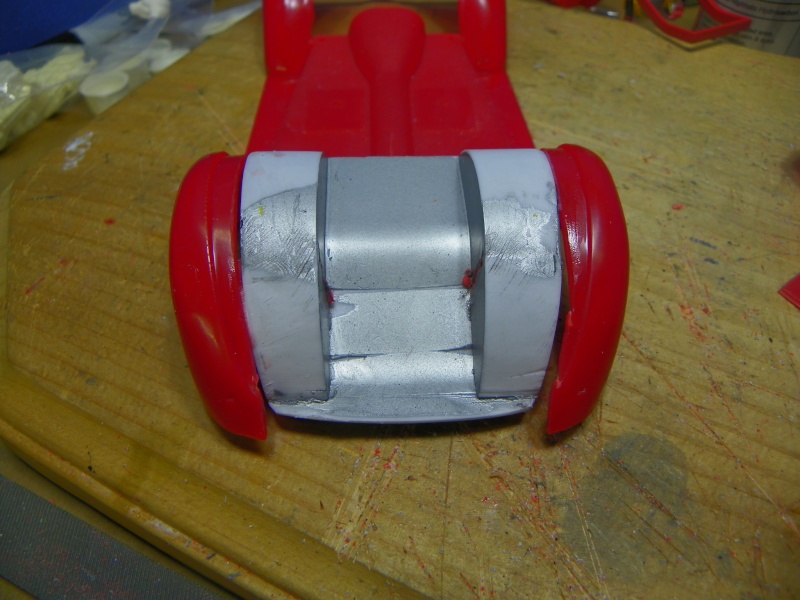

Then I cut the tubs from the Willys floor boards and smoothed them up a little bit.
Here is a half way done shot to show you what I am talking about.
1937 Ford Sedan Pro-Street 100_7318
The wheel wells on the 37 fenders aren't round they are kinda elongated. I cut the tub half way off the floor pan and added a wedge to give it a shape close to the Ford fenders.
1937 Ford Sedan Pro-Street 100_7319
This gets things close enough that I can MEK everything together.

With that all done I went to the back half. These two pictures will show you the 4-link setup. The springs are some more shift kit springs from a Ford Transmission. I painted them with Dulpi-color Anodized Blue over a silver base. I wish I had used a gold base but I am not changing it now.
1937 Ford Sedan Pro-Street 100_7526
1937 Ford Sedan Pro-Street 100_7527
With all that done it was time for another mock up. I wanted to check the stance and see where it sat. Here is how it looks.
